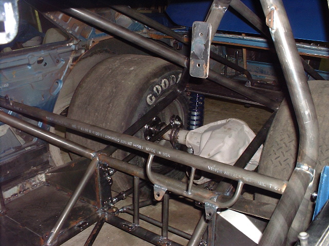

As big as you want to put in there... is just a matter of how much work you want to do  duster
