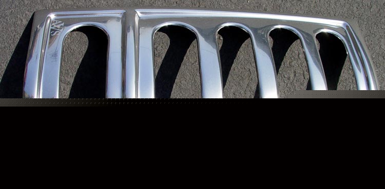

Originally chrome was vacuum deposited on a clear laquer sprayed on the plastic. The problem, it wears off and deteriorates over time. Originally the whole piece was vaccum plated, then they painted in the black areas. You can send your chrome out and have it restored, but its pretty expensive.
I found an alternative.
There is a company that makes mirrachrome, its a paint that truly looks like chrome, not silver paint. Its expensive, but much cheaper than chrome plating. It won't fool a show judge, but its perfect for a driver. Its also the same paint that people have been painting fiberglass bumpers with.
They have a video here you can watch.
http://www.kustomrides.com/supplies/spray-paint-chrome-kit2.html
Flyboy......are you saying you painted that yourself?

No, I didn't paint it myself. That's from the company's website.
But yes, it can look like that. Its a 3 step process, the part has to be painted gloss black, sprayed with the chrome, then seal it with a clear. They sell it in spray cans, its about $110 for a kit. Watch the video from the previous link, they show you how its done.

Well, I just ordered a can of this killer chrome stuff. It cost me almost $50 including shipping. I sure hope this stuff works because my dash chrome looks like crapola!

I hope you ordered the 3 part kit. It needs a black base, chrome spray, then clear over the top. Dont forget to take before, during, and after pics.

Lots of luck...I bought a pint of this same chrome paint...I did as they said, and it clouded as soon as I put clear over it....Maybe they have improved on it, but it about drove me nuts......Let us know how it works for you..... Dunno

I bought a quart kit of the Mirror Chrome from Alsa Corp.  Cost me Plenty, but it works if you follow the directions.
I laid a little too much of the mirror chrome paint on these parts, so they started to dull.  I did use their black and clear coats.  The black they sent is some of the blackest black I have ever seen.  You can see colors in it!  Once you mist this stuff on it does look like chrome.  I went ahead and painted the black trim on these and stuck them in the GTS.  Here is what they looked like with the mirror chrome, before I painted the semi gloss black and installed them.
I will be doing the fiberglass bumpers on my Barracuda as well as the dash plastic parts.  I like the stuff, but it is very expensive.

I betcha this stuff has the plastic chroming guys shaking in their boots. You say its expensive, and it is, but it would cost 3-4 times as much to have them chrome it.

  I am building a 68 Barracuda to run Nostalgia Super Stock and it will probably have some lace paint hehehe.  The pic was taken in the kitchen when the wife wasn't looking.  Didn't trust leaving them in the garage!
  I hope to spray the bumpers for the Cuda, and the arm rest bezels for the GTS in the near future.  Right now I have bigger things I need to do.  Once I spray them I will post more pictures.

Here is another tip for you.  I used Ez-Off oven cleaner to strip the plastic trim.  You need buy the kind that says you don't have to heat the oven up. It is much stronger and will strip the paint and old chrome off of the plastic. Then you have a fresh piece to work with.  Best stuff I have seen for stripping them down.
Be sure to keep an eye on it, and clean off the Ez-Off with soapy water once it has stripped off the old paint.

Another tip, 50/50 bleach and water will strip off chrome, as long as there is no paint or sealer on top of it.
