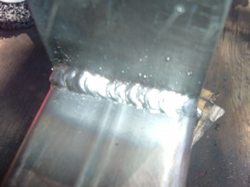

Just finished mine, first time for me too as far as welding, etc.  Just take your time and measure everything first (many times!).

Looks good. I wish I could train my car to roll over too.  Grin
