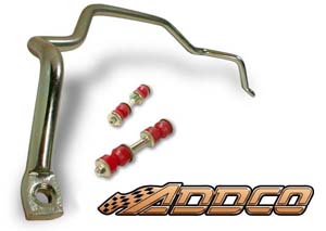

I retrofitted a front Sway Bar from ADDCO on my 68 Dart with 1973 Duster disk brake set-up. This particular front end had No sway bar stays..But the kit comes with mounting brackets. You do have to drill out a couple of holes on the K-member. No big deal.
It helped eliminate body roll very noticeably...
BTW, I had also retrofitted .920" torsion bars before going to the ADDCO Sway Bar. My engine is a 383.
http://www.addco.net/aftermarket.htm
