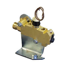

Retrofitted front Manual Dic Brakes off of a 1973 Duster. Work great.
We also installed a new Ford Mustang Proportioning/Metering valve
Here's some good poop on these items:
http://www.piratejack.net/Images/ebay/pv4.html
http://www.babcox.com/editorial/bf/bf50014.htm
