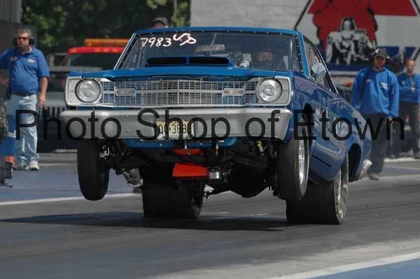

Got this dart weighed last week in preparation for its first drag race at Knoxville.So i have a alterKation front suspension,dana rear,cal tracs,hoosier 275/60/15 rear tire,summit aluminum drag thrust,comp.eng.8 pt.cage tti headers with 3"thunder bolt stainless mufflers,11 gal.of fuel.weighed in at 3100.Now for the fun stuff car ran the 1/8 at 7.334@94.118 mph.1.654 60' and a.050 light.now the suspension tuning begins to keep the tire spin at a minimum.tires were set at 18psi.all had a great time at knox dragstrip. thanks guys,and comments welcomed.thanks again Don.
