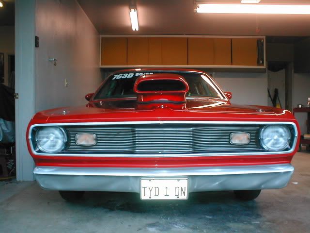

Picture intense. Chris Astons Chassisworks chassis. Not sure how much I will use. Roll cage and back half for sure. 4 Link. 440 Source 543 Stroker kit with their aluminum heads. Original was to do the chassis from firewall to the back. Want it to be drivable Pro Street with heater and wipers. Challenges are the foot bar, dash bar and the 2 bars running beside the rocker panels. Limited budget too.

Stroker windage tray. Studs, heads and mains. 10:1 compression. Morosso pan. New oil pump pickup. Lunati Voodoo cam, 533. Comp Cams locks and retainers. Shumaker headers and engine mounts,

8 Camping trailer jacks reworked to level the car. Last jack just ahead of the rear wheel wells. I stepped in the trunk to start cutting it out and the car did a 3 foot wheelie. Just about dumped it on the ground coulda got hurt too. Must have been the balance point in a hollow car. Jacks were not tall enough for the rear subframes. Building the chassis starts by rebuilding the inner rockers if needed and mine needed some then overlay with 1/8 plate. a 1 5/8 cross bar goes between the rockers door to door, 22 inches from the centerline of the rear end. Your roll bar mounts vertically to this. Trial fitting it right now. The Halo bar gets trimmed to fit but is not perfectly horizontal. Notice the wooden dowels to bring it inline with the angle of the roll bar.

I made 45 degree gussets to strengthen the rollbar/halobar per the instructions. I made 4 inch gussets, 6 inch would have been better. We wanted it nice for shows. We were able to do the welding on the rollbar/halobar outside the car. Not possible with a 2 door post car. Wouldn't be able to get it back in the car. Added the diagonal bar. Keep in mind you do not want this angled over the drivers head. Something to keep in mind when you take the roll cage out and turn it upside down for welding.

Grinding welds and spatter off the roll cage then painting. The A pillar bars did not work on my Duster or my buds 69 Nova. Had 2 made. Haven't picked them up yet. Had 2 of the 3 chassis I originally bought and sold one to my bud. Need to get more bars to the sandblaster, I had my other bud store the chassis for me while I went through divorce. He had to store them outside. So they needed blasted.

why is the main hoop so far back?
It is a full race chassis and I am using it as a Prostreet car. It is designed to run three inches off the ground. With an engine setback I guess. I don't have room right now to store the seats that I will run. I don't want them trashed by the time I get to them. We wondered about the seat belt mounting being so far back.
