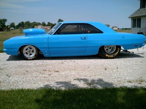

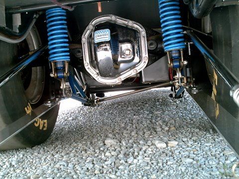

Here are some pics of my mock up.  Nothing revolutionary here, just thought some one out there might have an interest.  Seems like it has been a hot topic lately.  I am currently just mocking everything up, checking things etc.  I grabbed the centerlines of the new bolts of the original mounts.  Some of you may have seen my last post about the driver side being a bit off.  I elongated the hole and everything squared up really nice.  I measure diagonally from the spring perch centering bolts to the torsion bar mounts.  Both measurements are dead on.  At least within the 1/16" of the tape I was using. So I am pretty pumped right now that things are finally starting to progress.

Sorry no. This is the first go around on this car. Its previous state was bone stock with some old 6 leaf springs. I wanted to drop some weight and guys seem to have good luck with this setup.
