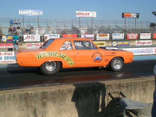

Magnum Force Coil Over w/QA1s 24x4.5 on Weld Prostar 15x4s Front
Stock Leafs moved 4" inboard 29.5x11.5 on Weld Prostar 15x10s Rear
"First time on it's own wheels on the ground in years"

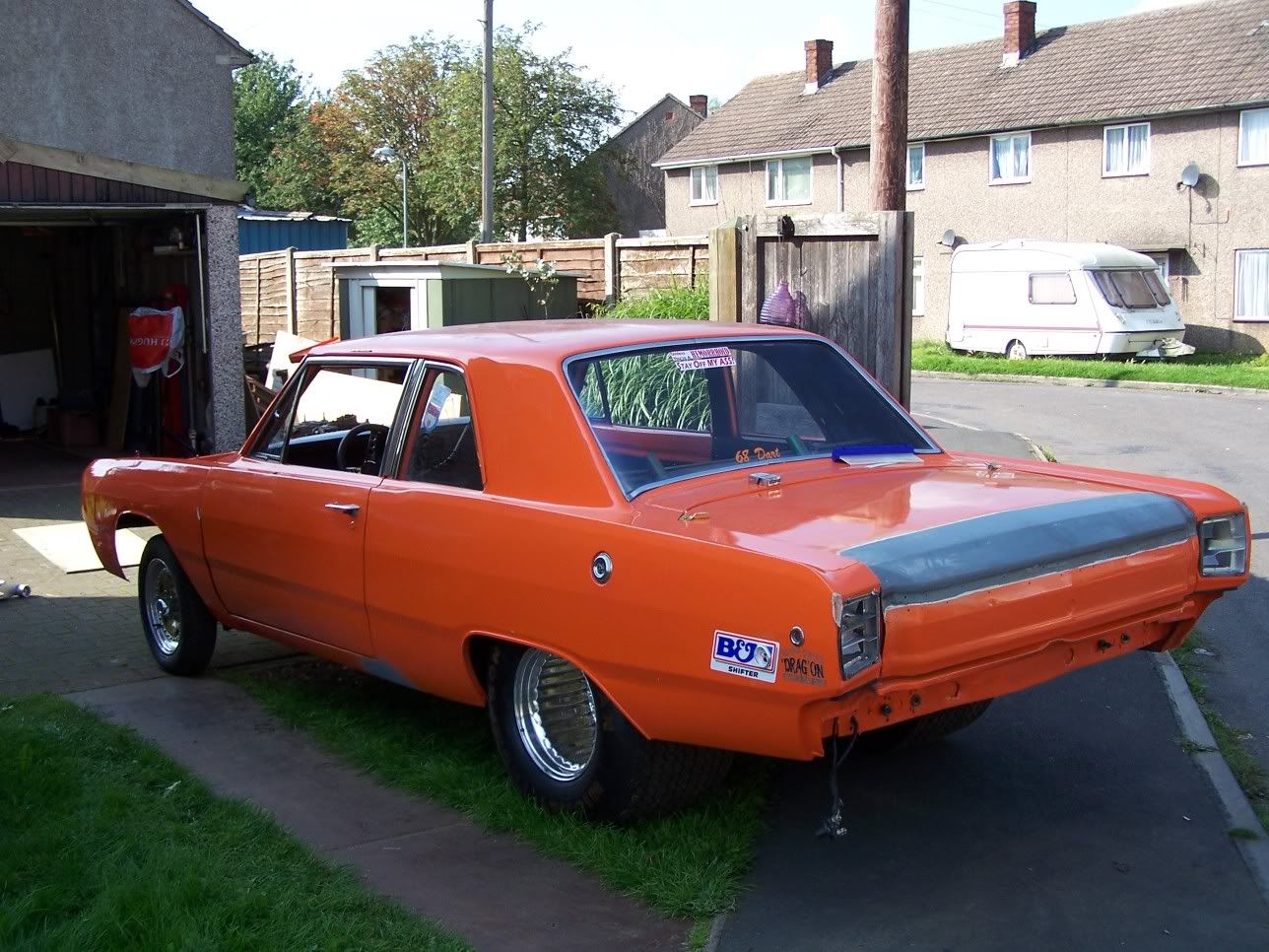

various stance of our dart..:)
way too high.. (the way we bought it)
new front end and the front sitting properly. rear too high. way too high..
added 1.5" lowering blocks until i get the new springs i want. sits a lot better..
new springs installed.. i think i may put a 1/2" lowering block in but i'll wait a bit to see if the springs settle some first..
