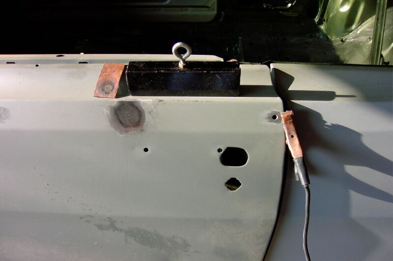

I posted 3 pictures with how I do it over on Moparts. (GTSDave) I use a piece of flat copper with a harbor Freight magnet to hold it to the back of the panel. Dont try it with a penny. They are not pure enough and will stick to the weld. The magnet is large enough to hold the copper firmly against the back side of the hole. I then took my mig and welded the holes up. I also kept a wet towel handy to help cool down the weld. If you go slow and dont try to weld up the holes all in one burst, you will be able to fill them without warping the metal at all.
-Dave
